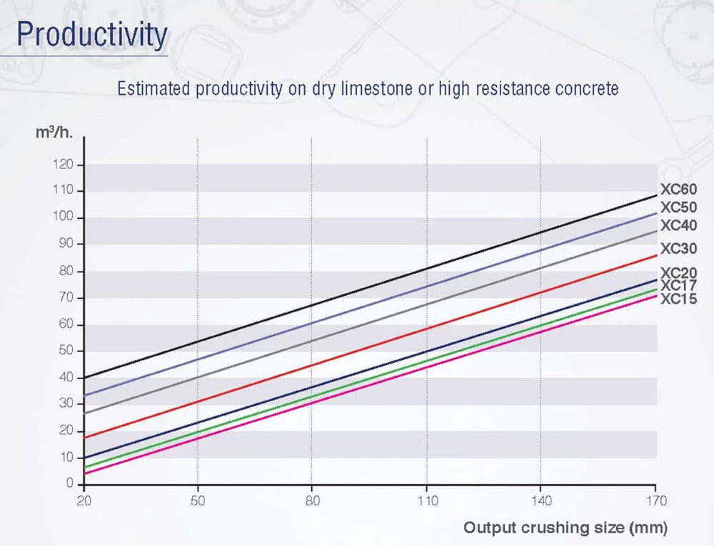

 Performance Highlights:
✅ Crushing Output: Over 130 + Yards Per Hour

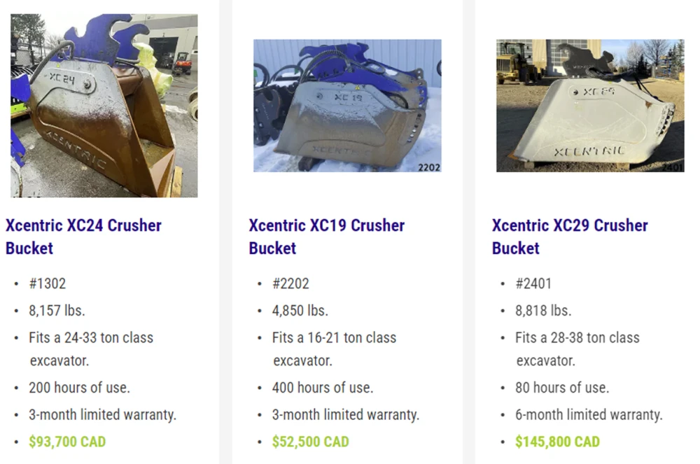

⚠️ Compare: Smaller used XC29 (½ the size) from Shearforce retails for $145,000 CAD - see image #6
 This is the ONLY used XC50 offered for sale anywhere in the world

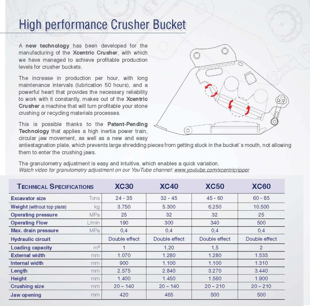

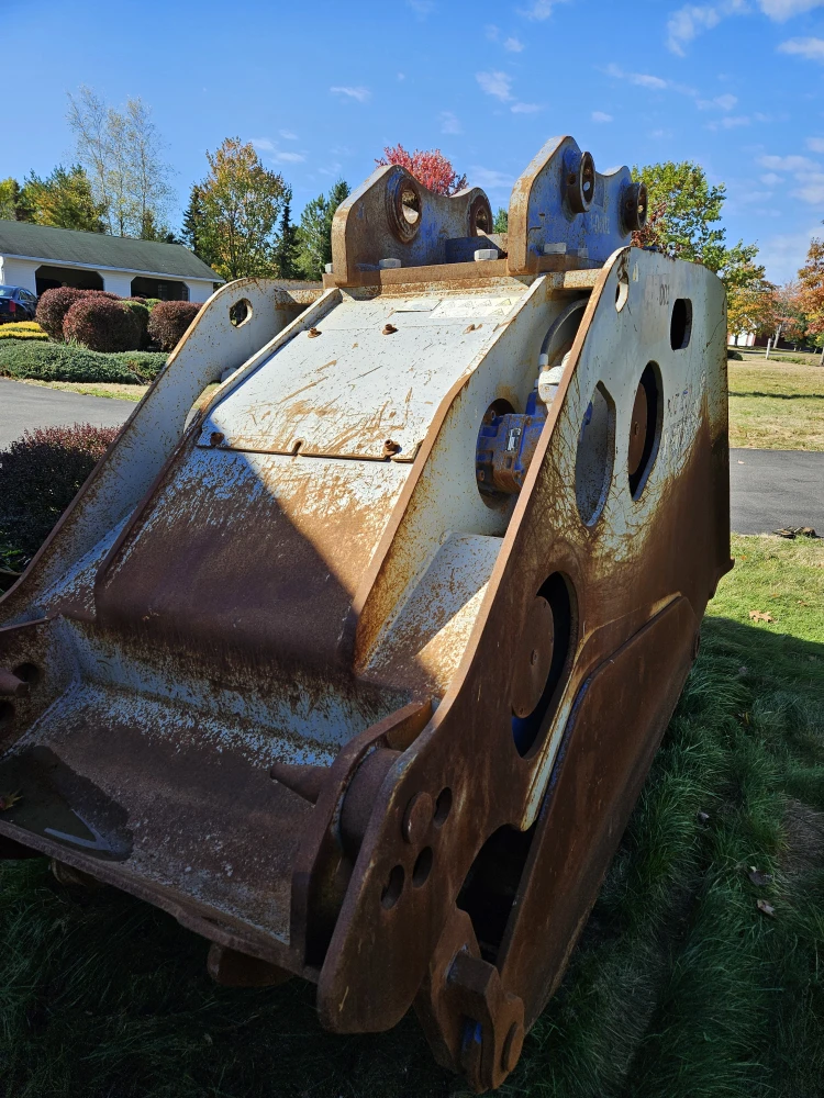

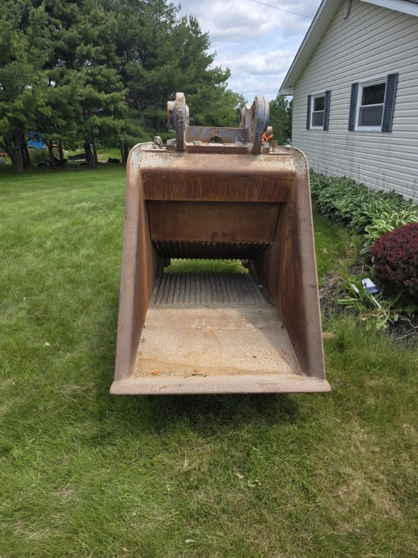

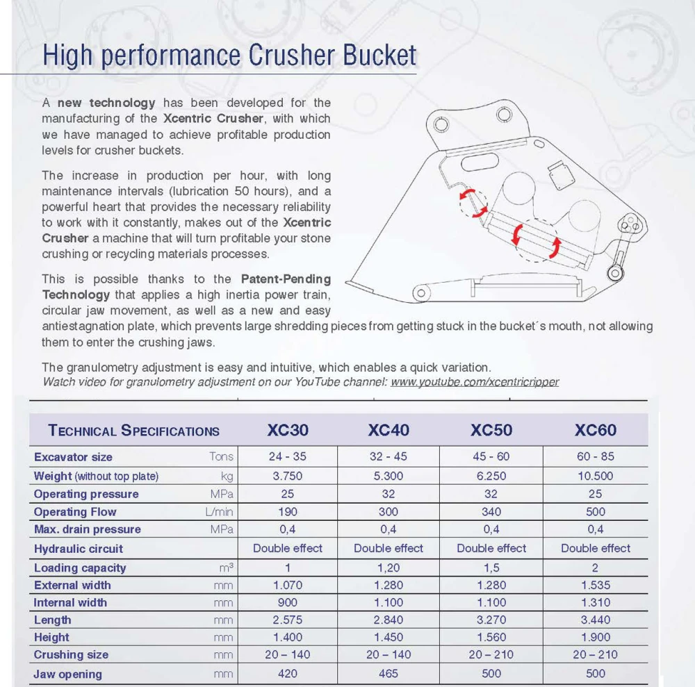

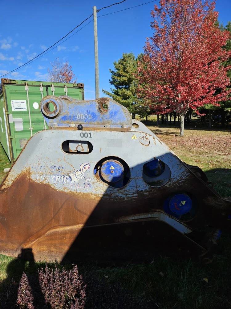

 Technical Specs:

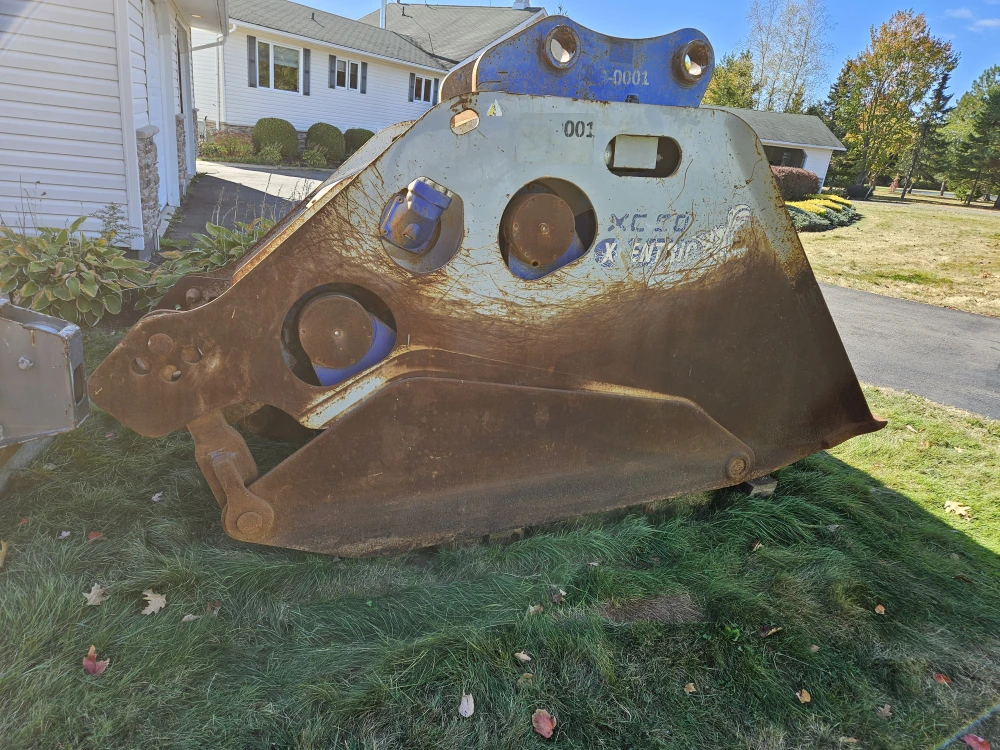

Model: XC50

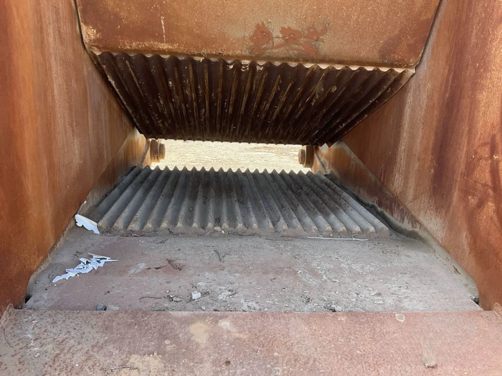

Year: 2020 - LOW HOUR UNIT DUE TO COVID NOT BEING USED - ORIGINAL JAWS OVER 80% - ORIGINAL  PAINT AND DECALS
Carrier Class: 38–65 Ton Excavators (Ideal: 45t+)
Note: We have a New Dealer Take Volvo EC380  off 8 foot stick we were going to mount on a EC380LC Volvo for quicker - easier - cheaper moves available for both this unit and the Rocktec Terminator 75000 ft lb drop hammer
Machine requires only a 2 way Hydraulic thumb circuit and case drain line - move the jaw bucket between mutltiple machines on multiple sites as required.
Weight: 6,250 kg
Jaw Opening: 1100 mm x 500 mm
Crushing Volume: 1.5 m³ per bucket = 2 Cubic Yards per bucket
Materials: HARDOX® 400, SSAB & STRENX
Stock #: XC50-0001
CURRENTLY SET UP FOR OUR VOLVO EC 480LC WITH AND OR THE VOLVO EC380 LC  AND COMES WITHB A SET OF NEW HIGH QUALITY PINS :
110mm FRONT PIN - 18.5 INCHES BETWEEN EARS
100mm REAR PIN 16.5 INCHES BETWEEN EARS
22.5 inches center to center pin spacing
Note:  The front pin is currently bushed for 100 mm pins for our PC450 Komatsu - easily rermoved.
 Engineering Advantages:

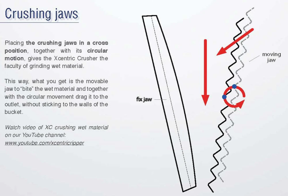

⚙️ Patent-Pending Circular Jaw Motion = Higher Output with Less Compaction
 Crossed Jaws enable crushing of wet or sticky materials
 Double-Effect System: Instantly reverse jaw if jammed—no need to empty
 Anti-Stagnation Plate: Prevents large blocks from clogging the inlet
 Minimal Maintenance Required:
Grease only every 200 hours
80% fewer wearable parts than traditional buckets
No springs, spacers, toggles, or silent blocks
 Anti-Skid Transmission with High-Inertia Power Train
⛽ Uses 40% less hydraulic oil—greater efficiency, lower fuel burn
️ All hydraulic parts are standard, available at most hydraulic service centers
 Built in Spain for extreme conditions with precise European craftsmanship
