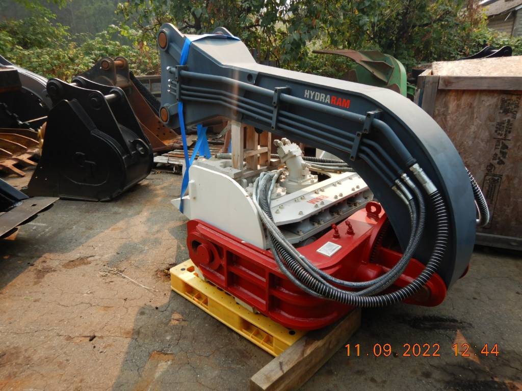

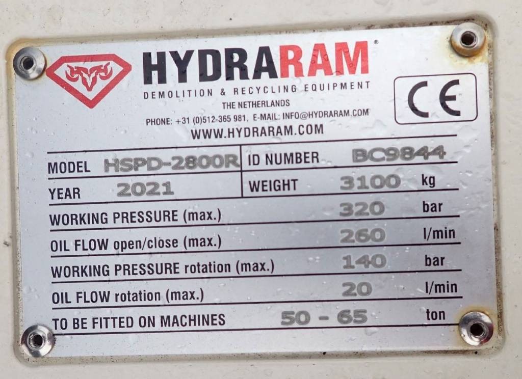

FOR SALE C/W WITH THE NEW 2021 175 HYDRAULIC HP HYDRARAM SHEET PILE DRIVER WORTH OVER $250.000.00  FOR $500.000.00

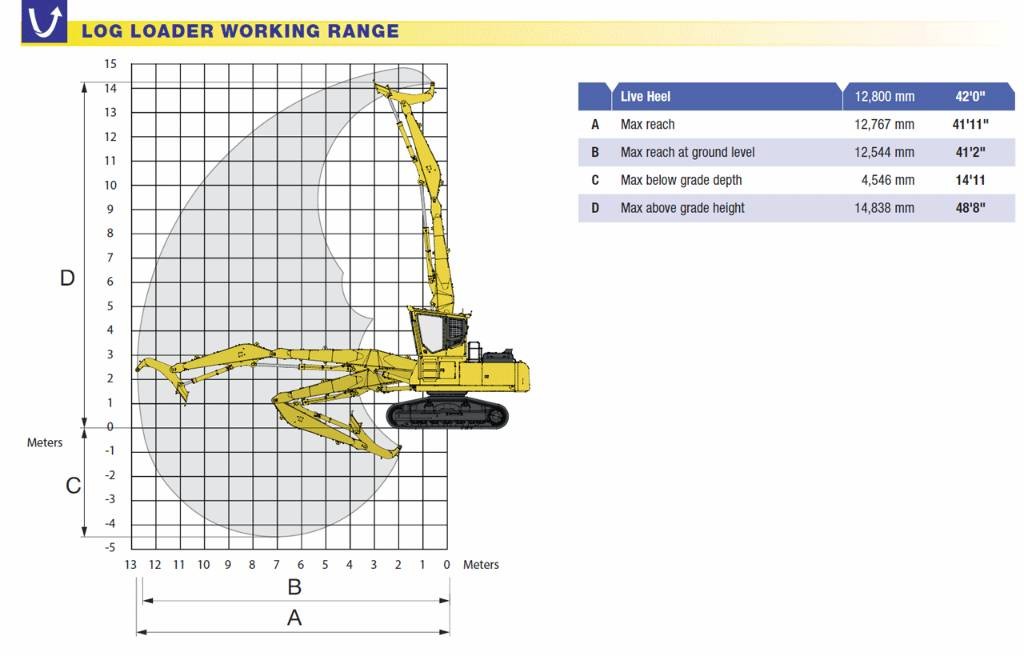

CUSTOM NEW ALL KOMATSU 60-FOOT REACH 3-PIECE BOOM FOR  LARGE HAMMERS - DEMOLITION PROCESSORS - GRAPPLES - GRAPPLE BUCKETS ETC - THIS MACHINE CAN DO EVERYTHING ON THE JOBSITE  INCLUDING DIG 30 FEET DEEP

1) DRIVE 40 - 50 -60 FOOT SHEET PILES WITH 175 HYDRAULIC HP SHEET  HYDRA-RAM SHEET PILE DRIVER

3) EXCAVATE WITH UP TO 2.5 YARD BUCKETS WITH  BOTH A VERTICAL AND HORIZONTAL REACH OF 70 FEET TO A STRAIGHT WALL HEIGHT OF 70 FEET OR TO A  DEPTH OF OVER 30 FEET:
4) TO USE A LARGE DUAL DRUM GRINDER TO A HEIGHT OF 70 FEET AND TO A DEPTH OF OVER 30 FEET
5) THAT HAS A TOTAL WEIGHT OF LESS THAN 110,000 LBS AND LOADED HEIGHT OF LESS THAN 14 .2 FEET SO AS TO BE MOVED ON A 8 AXLE LOW BED LEGALLY IN ONE PIECE

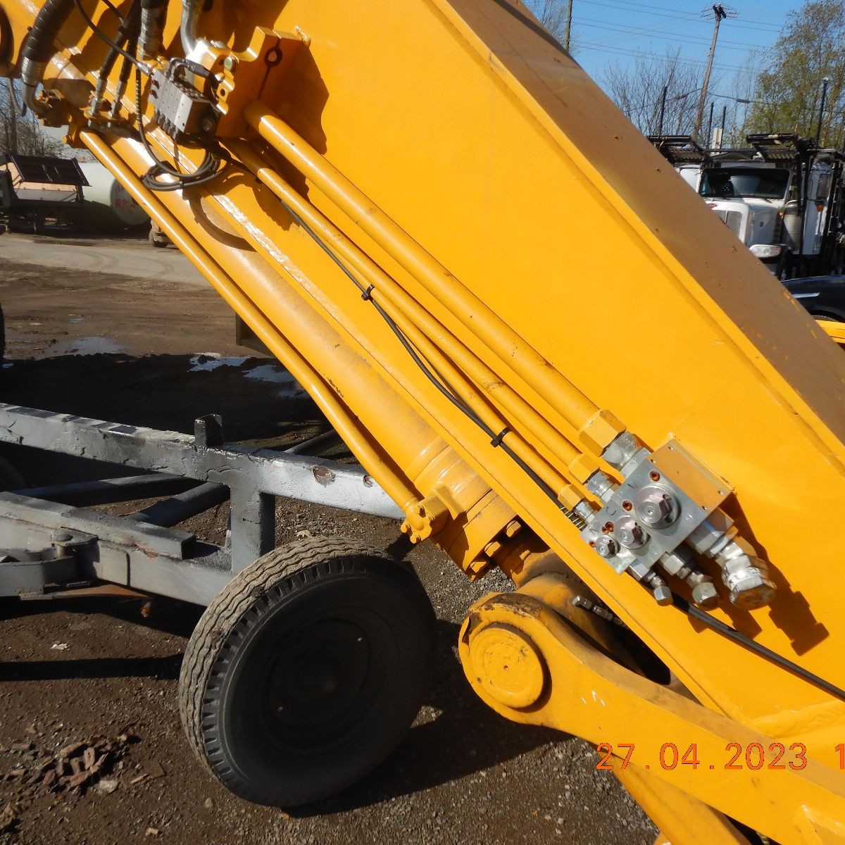

1) CUSTOM MODIFIED THE NEW FACTORY KOMATSU LOG LOADER 2-PIECE BOOM TO A NEW CUSTOM 3-PIECE BOOM
TO DO THIS THEY REMOVED THE EXISTING PC450LC-8 STICK - THE EXISTING STICK AND BUCKET CYLINDER - COMPLETELY REBUILT  - REBUSHED THEM - RE-PINNED THEM AND MODIFIED THE LOG LOADER BOOM
TO ACCEPT THEM AS A THIRD MEMBER STICK
2)  INSTALL A AS NEW GEITH HYDRAULIC PIN GRABBER COUPLER WHICH ALLOWS  FOR THE CHANGE OF ATTACHMENTS IN MINUTES HYDRAULICALLY

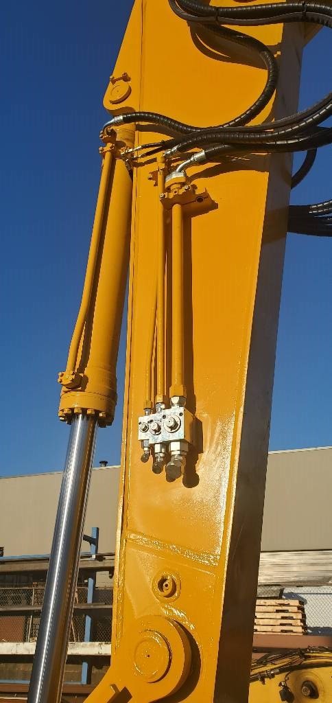

3)  INSTALL ALL-NEW HYDRAULIC HARD STEEL LINES AND SOFT LINES ON COMPLETE BOOM - REQUIRED VALVES -  JOYSTICK AND FOOT CONTROLS FOR THE THIRD STICK AND  3 HYDRAULIC FUNCTIONS PLUS CASE DRAIN

ALSO AVAILABLE IS A BRAND NEW 2021 175 HYDRAULIC HORSEPOWER HYDRARAM SHEET PILE DRIVER TO DRIVE SHEET PILE - H PILES ETC

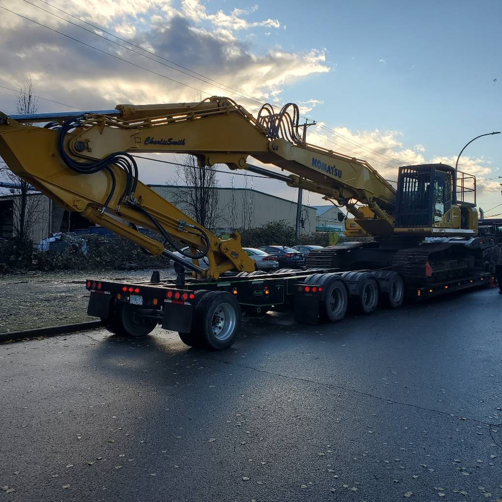

CAN BE MOVED COMPLETE ON 8 AXLE LOW BED WITH IT SITTING AT TOTAL HEIGHT OF 14 FEET ON TRAILER

CAN SHIP LOCALLY QUICKLY WE GET GREAT RATES AND SERVICE AND CAN MOVE THE MACHINE IN ONE PIECE - FOR HIGHWAY MOVES JUST DROP THE HYDRAULIC REMOVABLE COUNTERWEIGHT AND MOVE IN TWO PIECES WITH ALL ATTACHMENTS ON THE SECOND TRUCK
